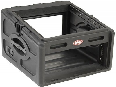

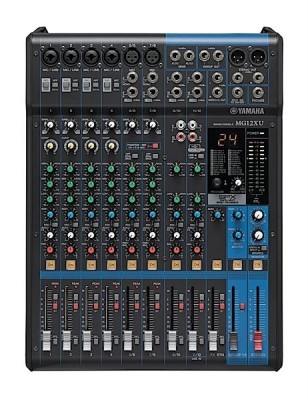

I have decided to go with the MG12XU after all. I have to get the rack kit from Guitar Center because Zzounds apparently doesn't carry it. I chose the rack that you originally suggested which Zzounds also suggested because of having more in stock than the other one that I asked about. Either one will work. The mixer is just less than 10Us.

That's awesome, Danny! I'm sure you will love your new setup. Congrats!

Instead of getting equipment to fit in your case, why don't you upgrade your case so you can get what you really want? Here's what you need that will fit the Yamaha MG12XU... https://www.sweetwater.com/store/detail ... -1skb-r104
Hey Alan, I'm not a user of cases so I need a little help with the case's info. I'm not sure how big is 10U or 4U or how wide is the area for the mixer. I have the Behringer 1222USB and I was wondering if my mixer will fit in the case you're mentioning? Can I also mount the GTD G-787 on the bottom? I would probably get the AV-8 popup shelf too. I'm hoping everything can fit nicely because this case will make life so much simpler in my mobile KJ gigs. Thanks for any info you can help me with.

I also have a Behringer X1222USB and it fits the top slant perfectly. And yes, you can mount the GTD Audio G-787 on the bottom. I've done that too. The antennas will be inside the case. It won't interfere with the range at all. Just try to keep other cables from touching them.
Remember; 1U = 1.75 inches (1 rack space). So, the top of the SKB would be 10U = 17.5 inches. I believe the Behringer X1222USB is around 12" so you'll have room to spare. And the GTD Audio receiver will take up 1 rack space on the bottom. Hope this helps/
Oh... The X1222USB is rack mountable. It even comes with the rack kit. So, you wouldn't need a shelf for the top, if that's why you were thinking of getting one.

S rack space is 1.75 inches if that helps. For the top take the depth of the unit and divide it by 1.75 and you should have the number of rack spaces. For the bottom it's the height you want to divide by 1.75 to get the rack space of the unit you want to mount there.

Thanks Alan, I really appreciate your help. The AV-8 is the popup shelf that mounts over the mixer so I can place my laptop on it. Looks like I might be getting this setup. Thanks again, you're a wealth of information!

I am having second thoughts about the 10u slant 4u bottom. I have almost decided that I am only going to run 2 wireless mics (the Sennheisers) and with the power conditioner I really only need 2u's below. It will make the rack that much lighter than adding another wireless receiver in addition. I am personally happy with the built-in effects processor in the MG10XU mixer that I presently hook into although I want to play around with the effects to see which one that I like the best.

I would go with the 4U bottom. It's not that much heavier and it's always better to have the extra space available if you should need it in the future.
