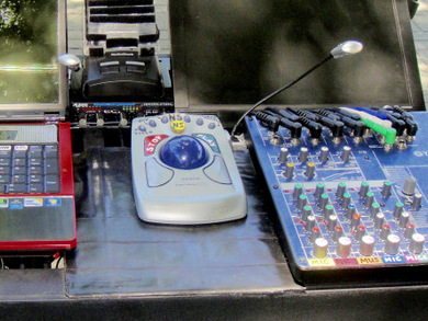

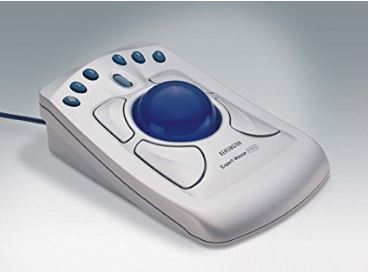

Trackballs rule! I use the grandaddy of trackballs the Kensington Expert Mouse Pro 64213.
Fortunately I have never had a situation that required a severe backup plan..... but I do bring spare parts and gear with me to every show. I have in years long gone, had to completely reboot and restart, and I have had to limp a little (such as poor video quality) on a couple of occasions.
Smoothe, I am glad you were able to keep going. 8)

A lot of buttons on the Kennsington.

I use 5 of them all the time. The bottom 2 are standard right click, left click. The upper left button (red) stops/fades the song in play, and the upper right button (green) is a "restart" of the song in play button. The top center button (yellow) is the "Next Singer" (NS).
The smaller buttons across the top are set up for "Clear Search" (escape), "Insert New Singer", etc. Every button can be programmed to do almost anything! It is the smoothest trackball ever.
Can't find this item new. lots @ ebay used.
compatibility: mac, pc xp & vista. (Win10?) Drivers still available for download?
I'd like to buy the newer version, Slimblade Trackball but my concern - only 4 buttons to click.
https://www.kensington.com/us/us/4493/k ... -trackball
'need to contact kensington support if this has the same functionality as your pro64213 with 10 buttons. I'm hopeful.

Hi Brian, I just noticed this reply from you. The Expert Pro Trackball is completely usable in XP compatibility mode on Win7 OS. I would suspect that it would work in 8.1 and 10 also. Kensington stopped supporting it in XP, but I have had zero problems with Win7.
I have 2 used ones and they are very sturdy, well built, trackballs with the smoothest rolling ball you have ever used.
