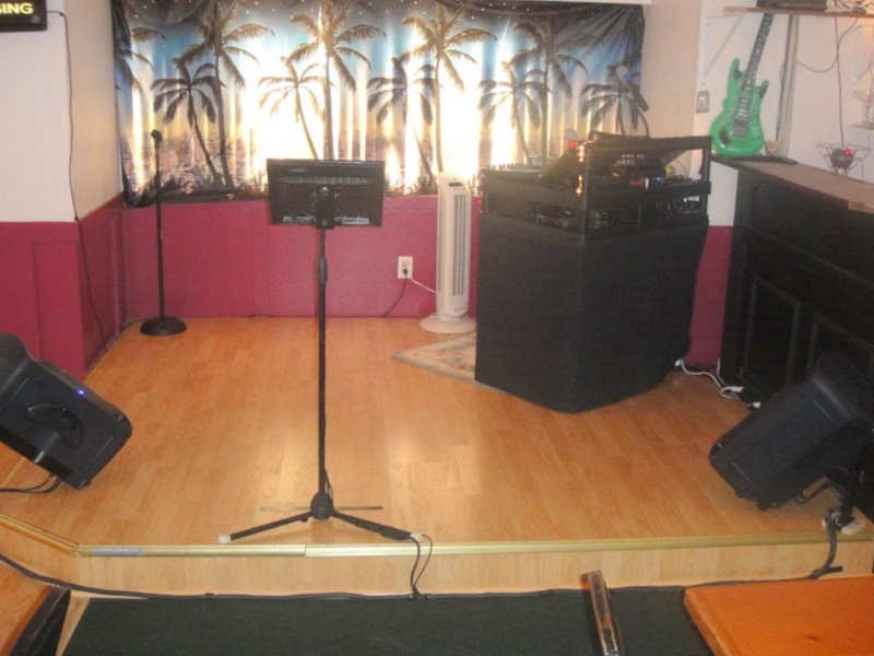

You have your lights mounted on your speaker stands ? What kind are they if you don't mind saying, looks good

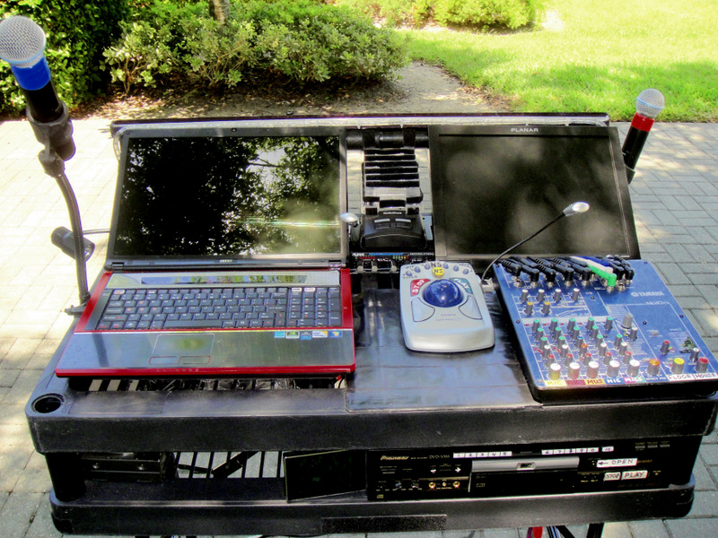

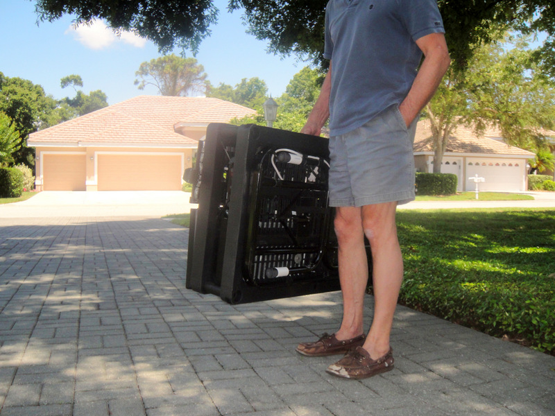

My table is an all in one solution. Everything except the laptop is attached including the table. It folds up and can be carried out with one hand.

Yeah, I clamp them directly to the speaker stands. Most of the time, I don't use dedicated light stands -- it's just more to carry around.
And it certainly makes it easier for the lights to "hear the music" when you have them set to activate with an audio trigger. The lights themselves are nothing special, but I have been good about using physically small lights that put out a LOT of light effects.

mrmarog, are those plastic shelves that you painted black?
PostPosted: Fri Sep 09, 2016 6:37 am
I purchased them from Home Depot about 8 years ago. They are black plastic. Home Depot shelves are now gray or tan. I also found a folding table and removed the laminate surface from it and attached it to the plastic shelving. The back rest is made from the spare legs with 1 inch pvc inside it for reinforcement.
I used a 1 1/8 hole saw and made several holes in the channels of the shelving and routed my wires through the channels. I have been using the same rig for 8 years. It has cracked in a couple of places but nowhere that causes any structural issues. You have to be careful with it, but because it a very small size it is easy to handle carefully.
It took quite a while to get it all figured out, but the end result was an extremely friendly and comfortable working layout. Ergonometrically speaking it would be hard to improve on. I have now removed the CDG player, the A/B switch and a few other items.

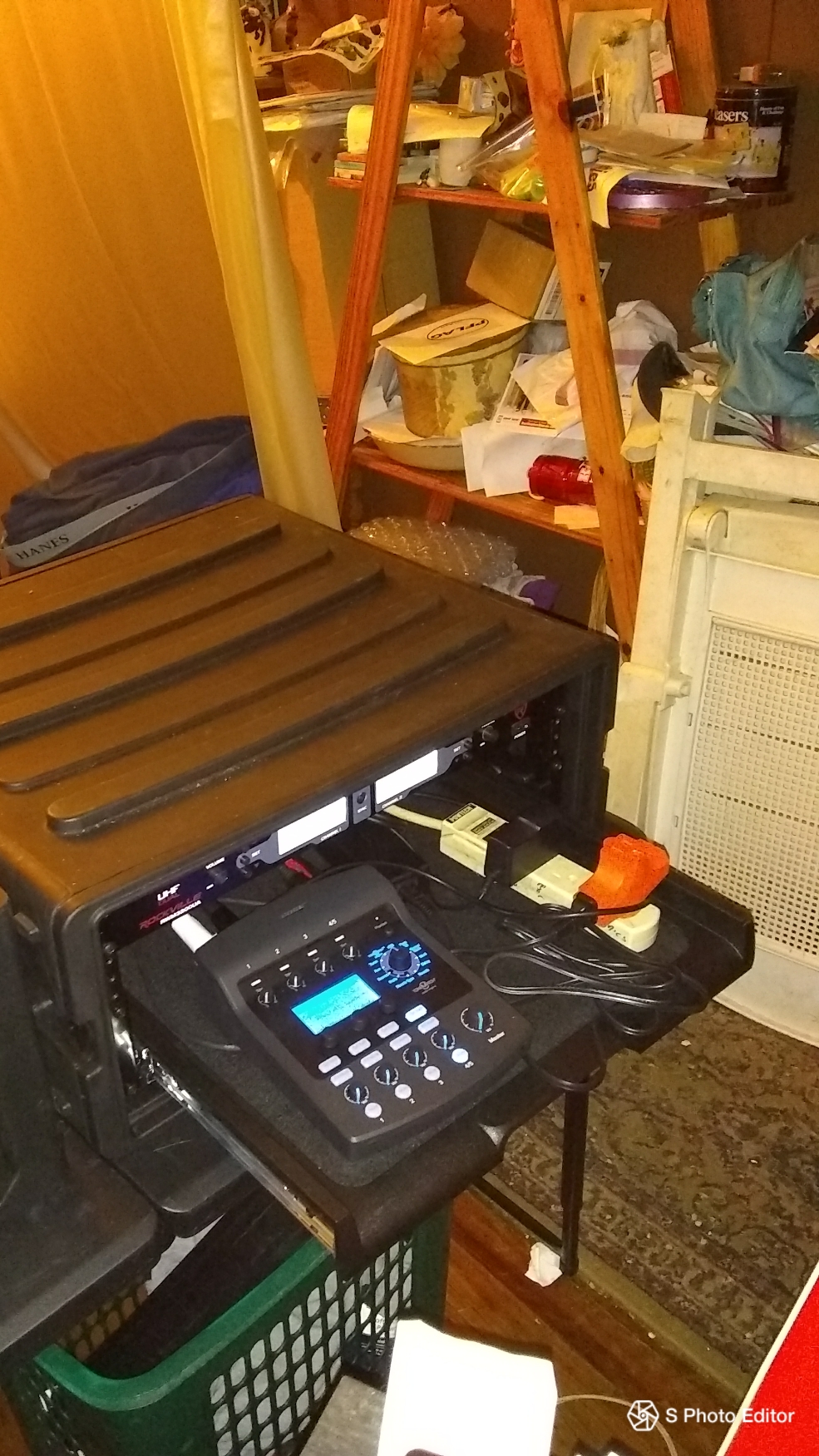

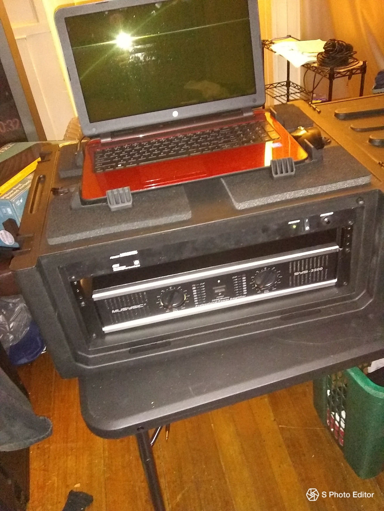

Finally got the new mixer. Below is the pictures of my setup.

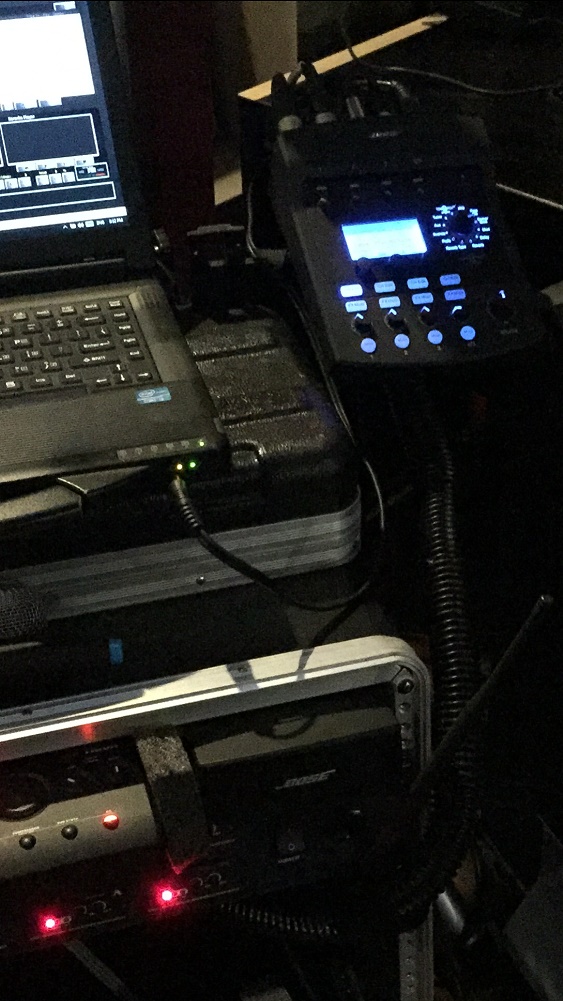

I use a wiring harness consisting of 3 XLR's for the mics, 2 1/4" cables for the laptop, 1 Ethernet cable for the router, 1 balanced 1/4" for main out, 1 balanced 1/4" for monitor out, 1 power cable for the T1 Mixer.

Why someone use a router?
PostPosted: Wed Dec 06, 2017 11:39 am
Possible reasons include remote requests and buying on the fly or digital mixer although the picture doesn't show a digital mixer.
PostPosted: Wed Dec 06, 2017 12:55 pm
Danny, If your refering to karaokeniagra falls picture in your comments above, the picture certainly does show a digital mixer, the Bose T1 Tonematch which is a digital mixer.
It looks like you also now have a Bose T1 Tonematch, correct?
PostPosted: Wed Dec 06, 2017 1:23 pm
The mixers that I consider digital usually are controlled via computer, Tablet or smartphone. As far I can see the Tonematch is more like a conventional mixer as the controls are on the mixer itself. and yes I just recently got a Tonematch. Haven't had time to use it in a real live show.
