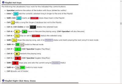

PostPosted: Wed Mar 23, 2016 11:29 am
MTU does have hot keys. Not quite as handy as the "F" keys, but it will do. Again, a mouse like I have shown can be programmed for a 1 button execution of multiple key strokes.
PostPosted: Wed Mar 23, 2016 11:48 am
bah.....I don't like CTRL and SHFT keys. And this is coming from a gamer that is accustomed to doing that every day. Karma's single key hot keys are what I am looking for. The programmable mouse is a solution, but I would need to do it x10. :/
