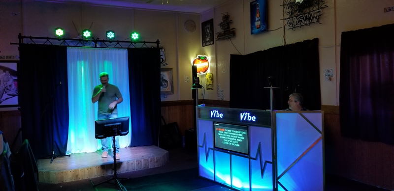

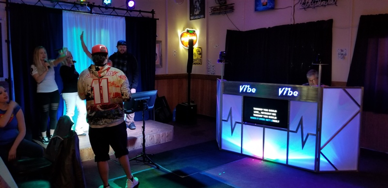

Hopefully this works this time. But here are a few pics of the new booth and stage set up.
There are lots more pics, but you get the idea.
The booth is 48" tall and 62" wide and is an aluminum frame backed with lycra fabric on velcro. Lighting behind illuminates through the fabric. I have a 30"X60" folding table for my gear. I do not have to use the facade if I choose. The TV is a 32" 720P. I use an HDMI splitter to send signals to both the tv's (booth and stage). The frame and tv together weight about 35 pounds.
I built the stage riser several years ago for the bar. It's small, but does the trick. It measures 6 foot by 8 foot, and it stays at the bar permanently.
The lighting is a simple 10 foot truss that tears down easily. I have attached a double curtain rod to hang the curtains. There is up lighting and down lighting behind the curtain, giving a glow effect. Time to set up or tear down the stage lights and curtains is about 10 minutes.
The tv monitor is simply a conductors stand cut down on the top part. It has four holes drilled into into it to match the four holes in the back of a flat screen tv. I use a 28" 720P TV rather than a computer monitor.
Total set up or tear down of the entire rig is about 45 minutes
Tell me what you think and give me some feedback even tho what is built is done, no changing.
There is a few things to explain, like the bar is a small, old dive bar that is in need of major upgrades.
Also, you can't see some of the lights in the pics, but they all work great and give a cool effect.
There are additional lights that hang from a truss that is attached to the side walls. The lights shine directly at the stage or in any direction I want. The truss is also permanently mounted at the bar for whoever wants to use it.
Set up at this bar isn't very flexible, too small of an area to make it look like it fits right, but it works for now. The end results were meant to be used at weddings, corporate parties, etc. But is flexible in its use at any venue. I can use all or part of the entire set up at any time.

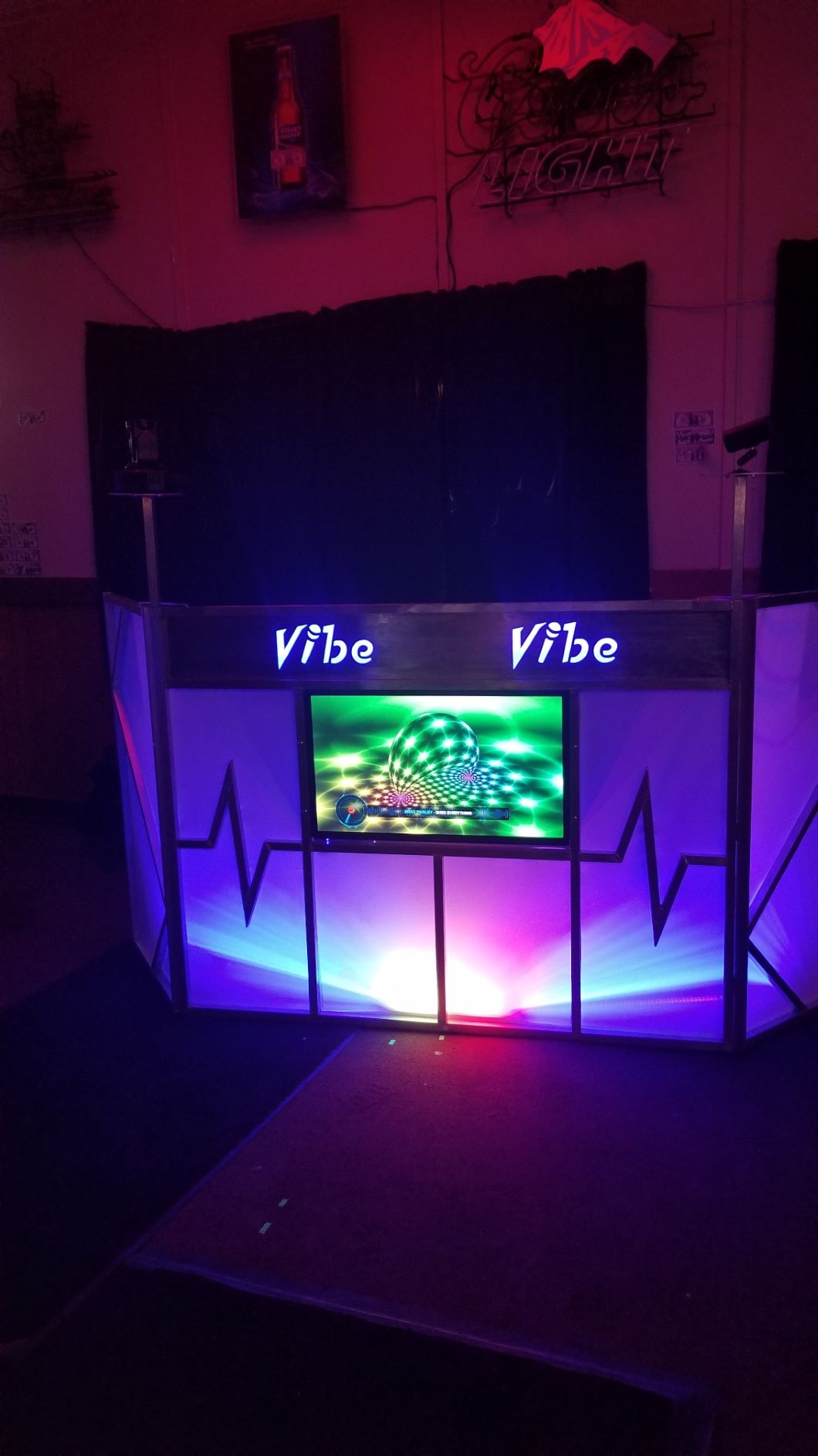

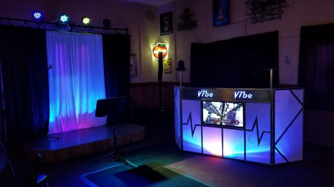

A couple more pics.

Mrscott it looks great and as others have already said it's very much a class act.
There is one thing I would recommend however. Look at the last two pictures. Both have the singers lit from the waist down while from the waist up they are back lit and their face is in shadow. What I would recommend would be to take your front light(s) cut the brightness down and tilt up to light the singer and not the floor of the stage (add a light if needed). If the lights have a gel frame holder use it. Get a diffusion gel (they're fairly cheap), this will soften the light, spread it out a bit and help keep from blinding the singer should they look directly into the light.
Looking at the pictures that would be my only suggestion, because other than that, I think you pretty much nailed it. Good Job!

I agree with that, the lights that are not shown that are in front of the singer on the truss up near the ceiling need to be tilted up just a bit. I just have been too lazy to too it is all. They are LED par cans and I can change the color all I want so as to not blind the singers, although the light would be coming from up higher so as to not do that in the first place. Good suggestion. Thanks for the comments Karen.

I adjusted the front lights last night. Makes a pretty big difference too.
