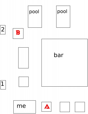

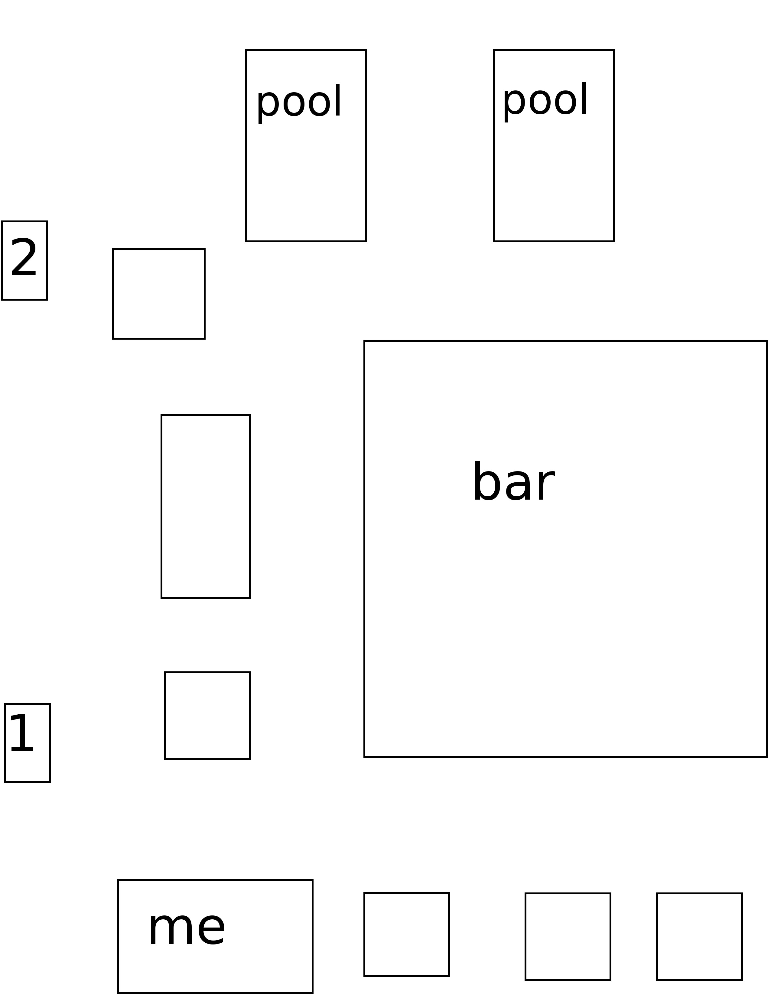

PostPosted: Wed Mar 21, 2018 4:16 pm
here is what we are saying as far as karaoke goes.
this is my main bar,
if I used stereo, a vast majority of the bar would only hear one source, and miss important information by missing that other side.

PostPosted: Wed Mar 21, 2018 6:09 pm
Consider this in stereo, Paradigm's bar on the one side would miss out on the beginning guitar riffs on Stone in love by Journey which are panned hard towards the other side. So Paradigm is right for wanting to run in mono in my opinion.

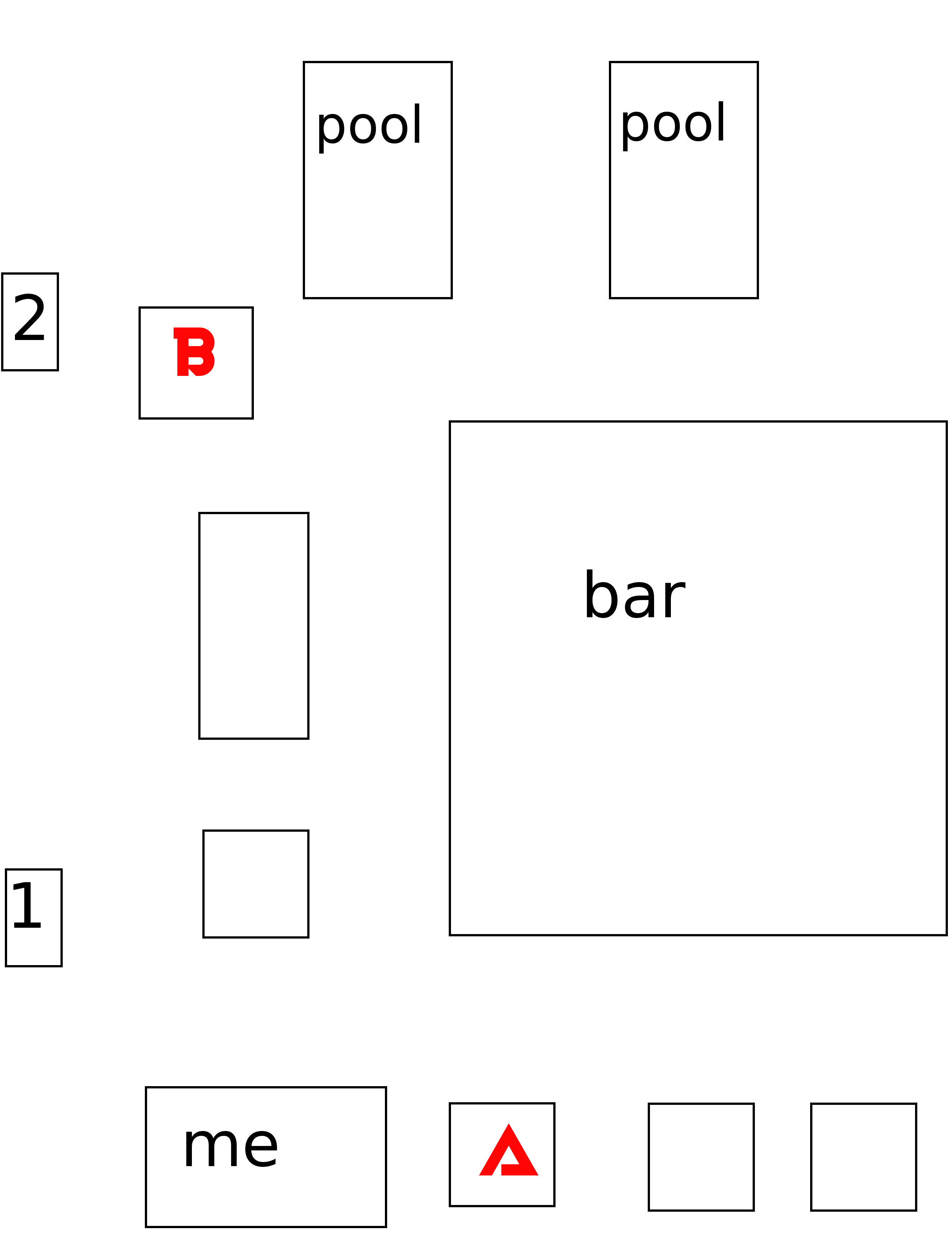

PostPosted: Thu Mar 22, 2018 9:35 pm
so i understand what you are trying to say Bastiat...
customer "A" is going to hear speaker 2 just fine and customer "B" and the pool players are going to hear speaker 1 just fine and get all the information from both speakers?
