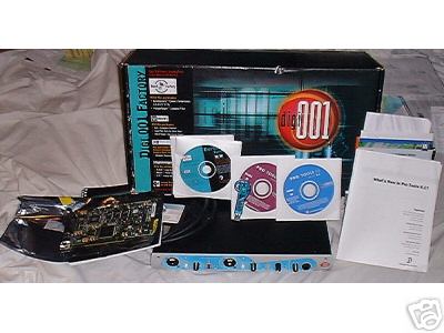

Hey Crystal...
Not that I know anything...and I mean that...But I have used only one recording package...ah I take that back I have used 2 one was cakewake and the one I use now is called Pro Tools LE. I bought it from Sam Ash and at the time it was a bit pricey (priceie Price...eee) but know on ebay you could get a DIGI 001 system with pro tools 5.3.1 for a really good price and make killer recordings...It might be a bit of over kill but it is killer. It does have a bit of a learning curve but once you get over that you will wonder how you ever lived without it...Check it out !! :roll:
File comment: Digt on ebay 475.00 but you can find it for much less...

The other thing, why not exchange the Tascam for a normal little mixer and PC soundcard . Easy to use and it works pretty much first time, every time.
