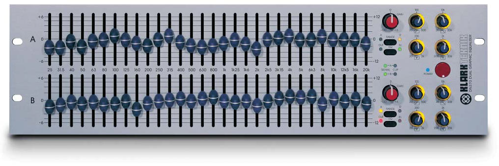

PostPosted: Fri Nov 24, 2017 4:06 pm
ok now you've got my attention. WHAT DO YOU MEAN TUNING A ROOM CAN'T BE DONE?
Are you saying that even though i've had the best sound for more than 25years, i've been doing it all wrong?
i think we need another opinion from Klark Teknik.

I'm sorry that you were offended but I was only stating the facts. Whether or not you have the best sound is of course subjective and a matter of opinion, but the only thing that really matters is if you are satisfied with your sound. As far as saying that you're doing everything wrong, well I said no such thing nor did I imply any such thing. As far as your reference to Klark-Teknik, they make good products or at least they used to but that doesn't allow them to defy the laws of physics, and indeed they can't. They wouldn't be the first company that makes audio products that implied that they've defied the laws of physics. I don't need to look any further than my own back yard to a company called Bose where I can get fed all the b.s. they're willing to hand out.
What I did suggest however is that you can't tune a room with a graphic equalizer or even a parametric equalizer for that matter. All acoustic spaces have their own sonic characteristics that can only be altered physically or mechanically, period. End of story this isn't even debatable, and I don't care what Klark-Teknik or Bose or any other company hawking their products has to say. There isn't an EQ on the face of the planet that can change room resonance, early reflections or standing waves. These are all characteristics of the physical space that a room occupies. I'm sorry you don't know that, but getting offended by the truth won't help you learn it either, that is of course if you are even interested in learning.
All small rooms have peaks and severe nulls at all low frequencies, not just the mode frequencies and that is determined by the room's dimensions. This has a profound effect on low frequency acoustic problems. For any given low frequency, there will be places in the room where a peak exists, and others where a deep null exists. Likewise, for any given location in the room, there will be frequencies with a peak in the response and others with a null. Nulls occur at a distance from most boundaries (walls, floor, and ceiling) equal to 1/4 the wavelength of the frequency. Other nulls occur at odd multiples of that distance: 3/4 wavelengths, 5/4, and so on and so forth. Peaks on the other hand occur at even wavelengths, 2/4, 4/4, 6/4, etc. This should be evident to you by now that you can't alter the physics of peaks and nulls with an EQ.
There are just so many variables that for Klark-Teknik to suggest that they can "tune a room" (that is if they indeed actually have made such a claim) with a static piece of electronics such as a 31 band graphic EQ that can magically address these issues and other issues such as comb filtering, phase issues, standing waves, acoustic interference is downright laughable. By the way, when pink noise is analyzed in bands, the levels of all frequencies within each band are averaged together. Even measuring at 1/12th octave spacing is far too coarse to see the true room response so even if you could "tune the room" with an EQ, how could you possibly do that with a 1/3 octave (31 band) equalizer?
The only thing you can do is alter the frequency response of your sound system, and aside from speaker placement, like I said in my last post in some cases that might be the best you can do, but you do so at a cost. There's no such thing as a free lunch. You can't alter the room resonance because it's a direct result of the room dimensions. I'm including that formula and other formulas in my book. You can learn a lot about a room if you want to dig deeply by loading Audacity onto your laptop. I'm also giving away a test signal CD or a link to my website along with some other goodies with an audio file that contains a sine wave sweep of 260 sine waves in increments of 1 Hz from 40 to 300 Hz, along with instructions. There are a whole bunch of other cool things you can do with Audacity or any other DAW that if nothing else some might find educational. These are the kinds of things i will be addressing in my book, and hopefully a lot of fun stuff as well.
