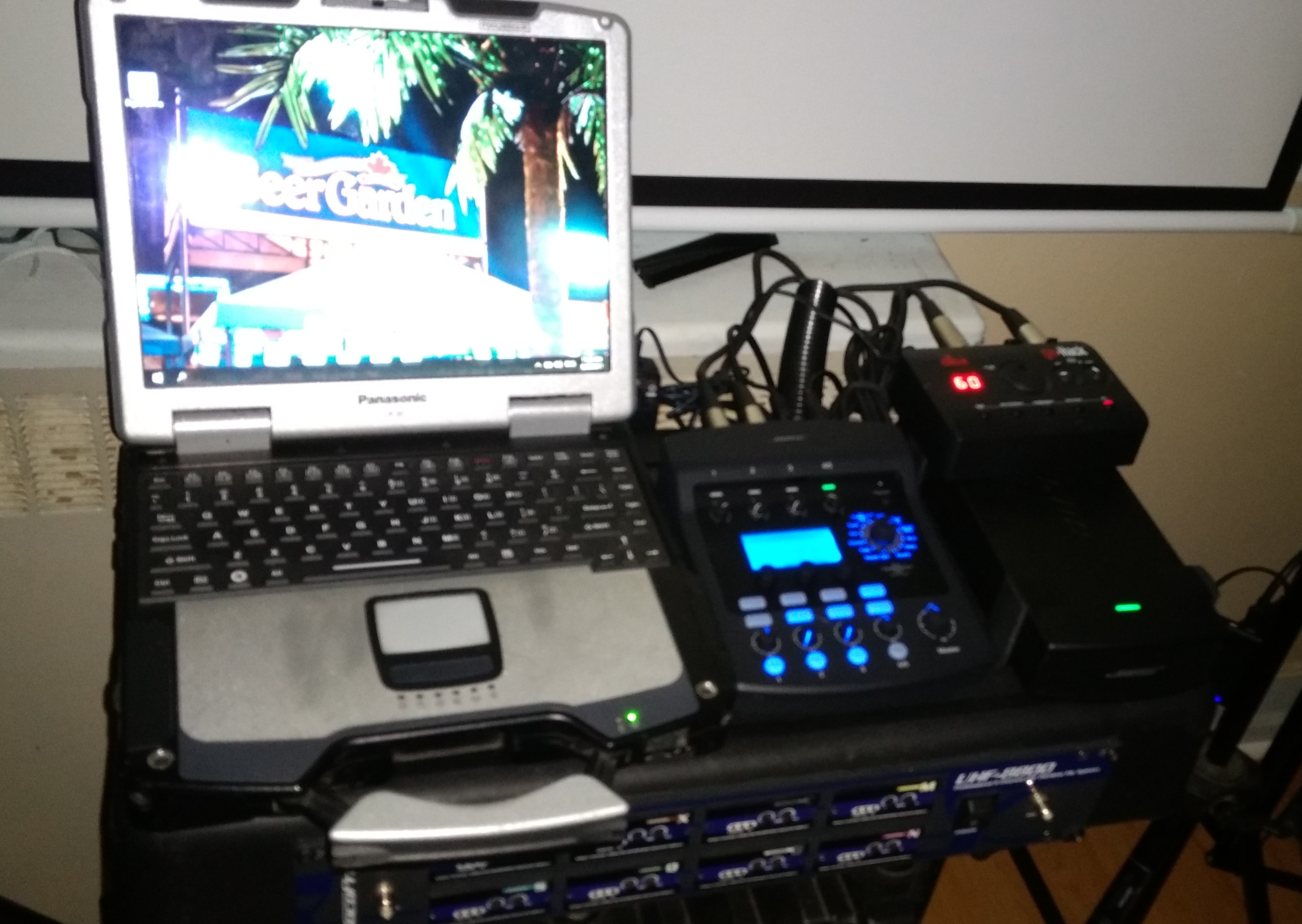

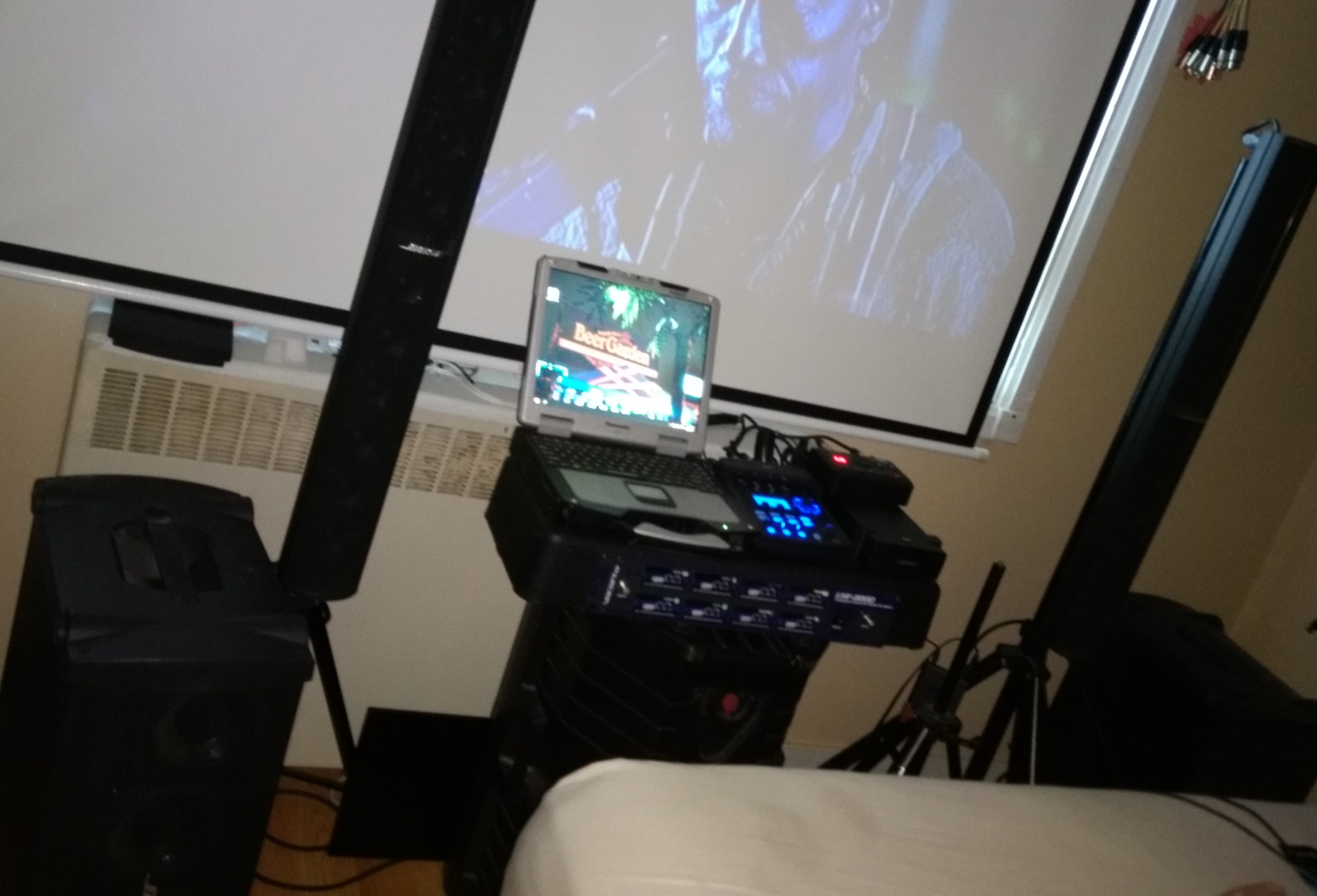

I've decided to put together a semi-mobile karaoke system for use in School Auditoriums / Lounges / mid-size night clubs.

There's this thing called 'focus'.
What kind of mixer is that?
DJ Don
PostPosted: Fri Jun 23, 2017 9:19 am
It's a Bose ToneMatch. She has never taken an in "focus" photo..... not that I remember.
PostPosted: Fri Jun 23, 2017 6:33 pm
yes it's a BOSE T1 Tonematch digital mixer with 1-3 mic XLR inputs and 4-5 stereo 1/4" inputs, can also use the USB to route laptop to Channel 4/5 or direct to master channel out.
Has built in FX (Delays, Reverbs), Compressor / limiter for each channel. (Very nice setting Threshold to -30db and makeup gain to 20db I use for keeping a sweet volume balance for the ever so changing karaoke tracks. I know its a little bit overkill for compression, but is very sweet.)
Mixer is unpowered but works absolutely perfect with the Packlite A1 amplifier as shown to the right of the mixer. 245 watts @ 4 Ohms.
The Bose A1 amp is very intelligent in detecting the MA12 Full range arrays and setting a very nice cross-over point to match with the MB4 Sub. (connection 1 MA12 Array + 1 MB4 sub connected in parallel per amp)

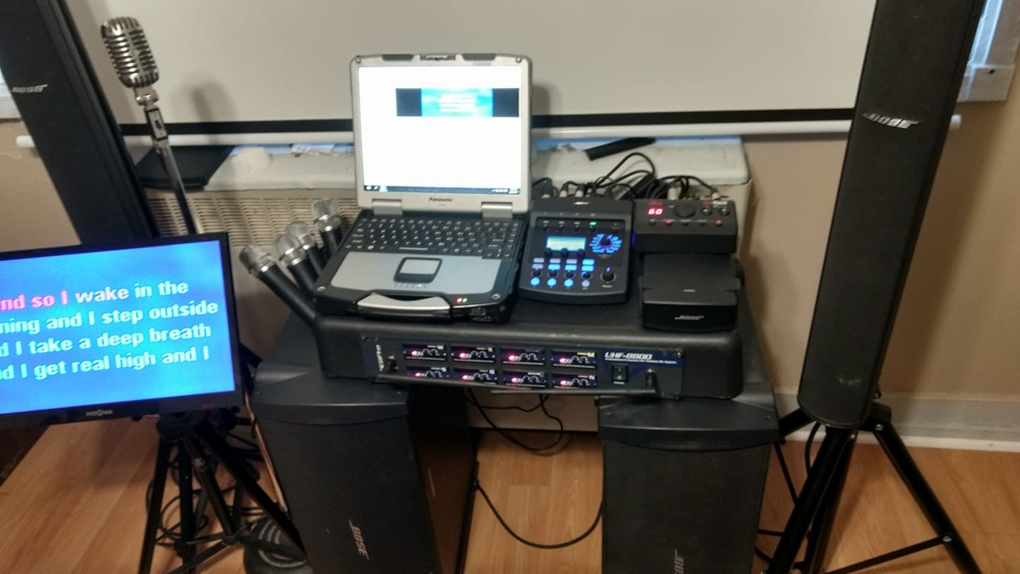

Sorry, I need to take lessons in Photography.
Main speakers > BOSE MA12 Panaray
Subs > BOSE MB4
Mixer > BOSE T1 Tonematch w/ standalone Power adaptor
Amps > BOSE A1 Packlite (also provides auto internal processing and crossover settings)
Processor > DBX GoRack (Used mostly as a feedback controller)
Wired Microphone > SHURE SH55 Series II
Wireless Microphone > VOCOPRO UHF 8800 modified with 6 handhelds and 2 head sets
Speaker Wiring > Neutric Speakon Connector cables (6ft connects MA12 & MB4 in Parallel) (25ft connects MB4 to each A1 amplifier)
Computer > Panasonic CF-30 Rugged touch screen laptop connected via USB into the T1 Mixer.
CDG display > INSIGNIA 19" LED tv
Reverb / Delay / Compression / EQ all used in the T1 mixer.
All-in-all this system provides a very nice crystal clear sound with lot's of power (245watts per side @ 4Ohms) perfect for mid-size (200-500 people) events.
Amps can also be daisy chained using the THRU output for adding even more speakers/subs for larger events.
