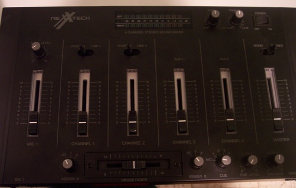

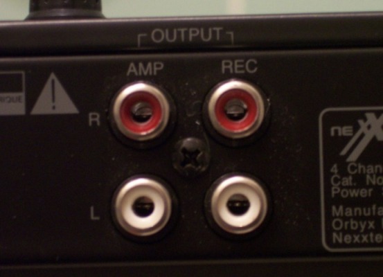

I have taken pictures of the input and the output connections at the back of the mixer. It has a place for two mics, and the spot for the headphones (different plug ins, not shown on the pictures. )
The thing I am most unsure about is what kind of cords to get to connect the mixer to the computer.
I will probably go to Radio Shack to get the cords, but I don't know if they will know what they are talking about :)

How do the mic input look??? Are they xlr connectors? Do you have any connectors on the top close to the mic connector? Could you submit a picture of the top also? Then I can better advise you.
At least looking at the pictures you showed me you need a 3.5 mm male stereo jack to dual phono plugs. Radio shack has such an adaptor.
Then you just need to connect a regular stereo phono cable between the rec out and the computer line in.

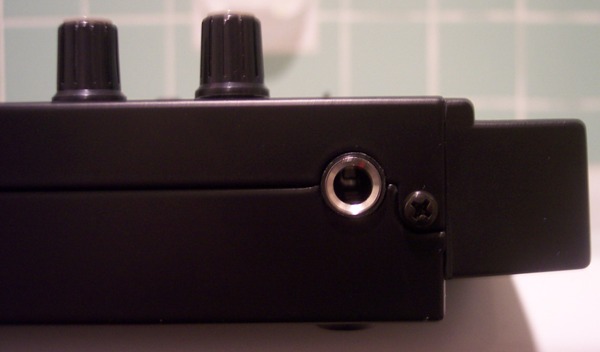

Okay, I have taken a picture of the top of the machine, and the mic/headphone inputs (they are the same)
I know I will have to get an adapter for my headphones to fit into where they plug in.

Ok, this looks like a dj mixer.
the microphone input looks like a 1/4" phone plug. It is probably unblaanced -- do you have the manual?? If it says TS it is an unbalanced phoneplug. If it says TRS it is a balanced ("stereo") phone plug. If you have a pro mic (with a male XLR connector) you need a female XLR to male 1/4" TS phone plug cable. Get no more than 10-15'. The mic signal is weak and you don't want noise on it.
To connect the output of the mixer to the computer you need the connections I described above. You might have to experiment whether the mic signal goes both to the record as well as the amp outputs. Since this is a dj mixer you might only find the mic signal on the amp outputs. You also want to check if it turns down the music when there is a signal in from the mic.
Since there is no direct out. It is easiest to use the mixer as a mic pre-amp only. You can then connect the headphones to the line out of the sound card. In this way you do not get latency free monitoring.
Alternatively, you might be able to have the mic go to the output while at the same time monitoring another input with your music. You have to look in the manual or experiment for that. If that is the case you can attach the headphones to the mixer and enjoy latency free monitoring. Since dj's typically cue one song while playing another this should be possible. If you do this you need another 3/5 mm stereo jack to dual phono plugs and a stereo phono cable to connect the line out of the computer to the mixer.

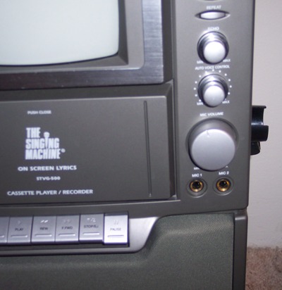

The mics I have all can fit into these ports on my karaoke machine.
I do have a wireless mic that has a female adapter that fits into the microphone and then the other side fits into the karaoke machine.
I dont' have any pro mics....I ususally dont' do much else with them but practice, I am waiting to get a house and then get the expensive stuff...just so I can learn that I am getting the right things without spending too much money first LOL!
I should also be able to connect the karaoke machine to the mixer....and use that as well, instead of just recording staight through the mixer??

If your mics fit in your karaoke machine (which probably also is 1/4" TS) you should be good to go. Have you tried to connect the mic the mixer and attached your headphones?? You should be able to do so right now.
Morten
