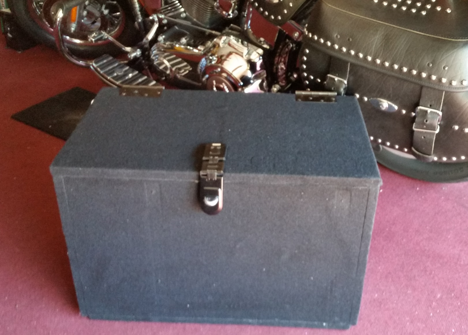

Agree with Lon & Srinity. They’re very expensive. DIY (do it yourself) Earl. It’s cheaper. All you need: plywood, wood glue, nails, utility blade, 3M 77 adhesive & dj speaker carpet.
Carpet: http://www.ebay.com/itm/10L-BLACK-CAR-D ... 3f09d0d642
Carpet Adhesive: http://www.homedepot.com/p/3M-Super-77- ... /100067550
Side Handles: http://www.ebay.com/itm/Seismic-Audio-P ... 1e99914802
Cut plywood according to your tv dimension. Lowe’s/Home Depot will even cut your plywood to your specs, 2 cuts free, 50 cents per cut thereafter. Apply wood glue & nail it. Cut your dj carpet to size, spray carpet (not wood) generously with 3M 77. Wrap it around your box & cut/trim using utility blade. Easy does it! Pic below, box I made for cables & such. Not really a tv monitor box - but just giving you an idea that it’s easy to make one. Let your imagination do the work. You’ll be surprised what you can do. Good luck.
