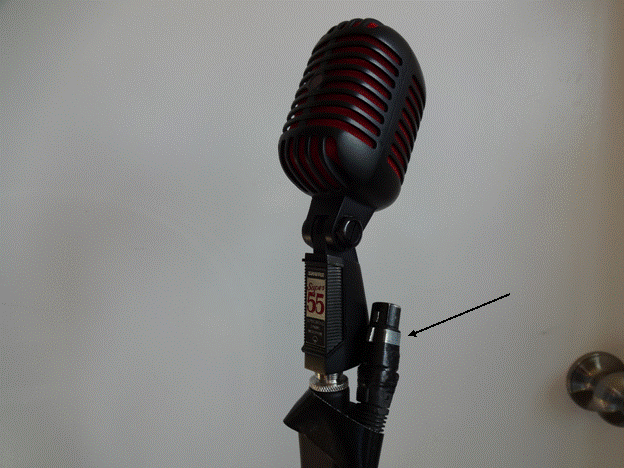

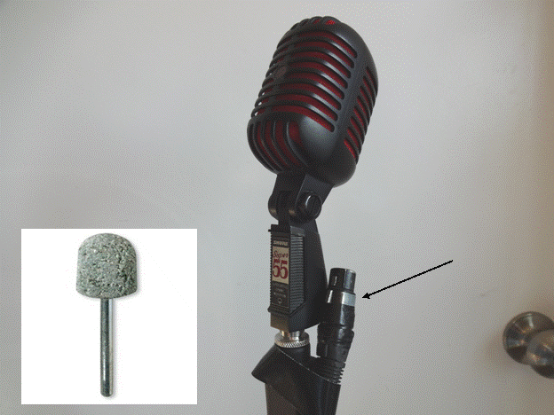

Any mic stand will do, chris. I’m using the grip style. No xlr cable will fit unless you file/trim the side-end with a flat steel metal file, easier to use would be an abrasive stone bit & attach to your power drill. (sorry to include the file in the pic, having a senior moment I can’t recall the exact name for it). Make sure you align first. Mic not attached to the mic stand, connect the cable to the mic & mark left & right end before filing to get the exact placement. Don't file too much. Always, file a little & try the fit until you get the exact trim.

After a trip to the Home Depot, it dawned on my that I could just file down the XLR connectors as needed. Thanks for the parallel tip, Brian. I have a Dremel tool with some of those attachments. Will be doing some grinding later today.
