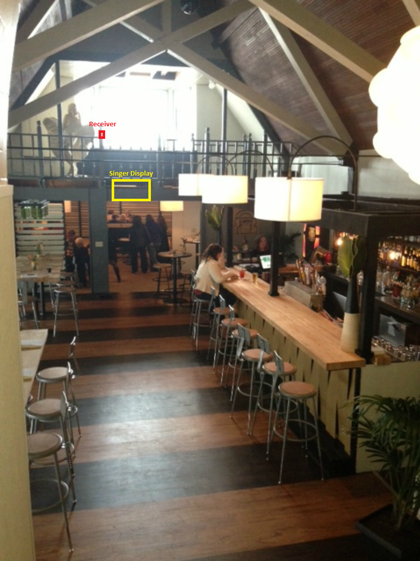

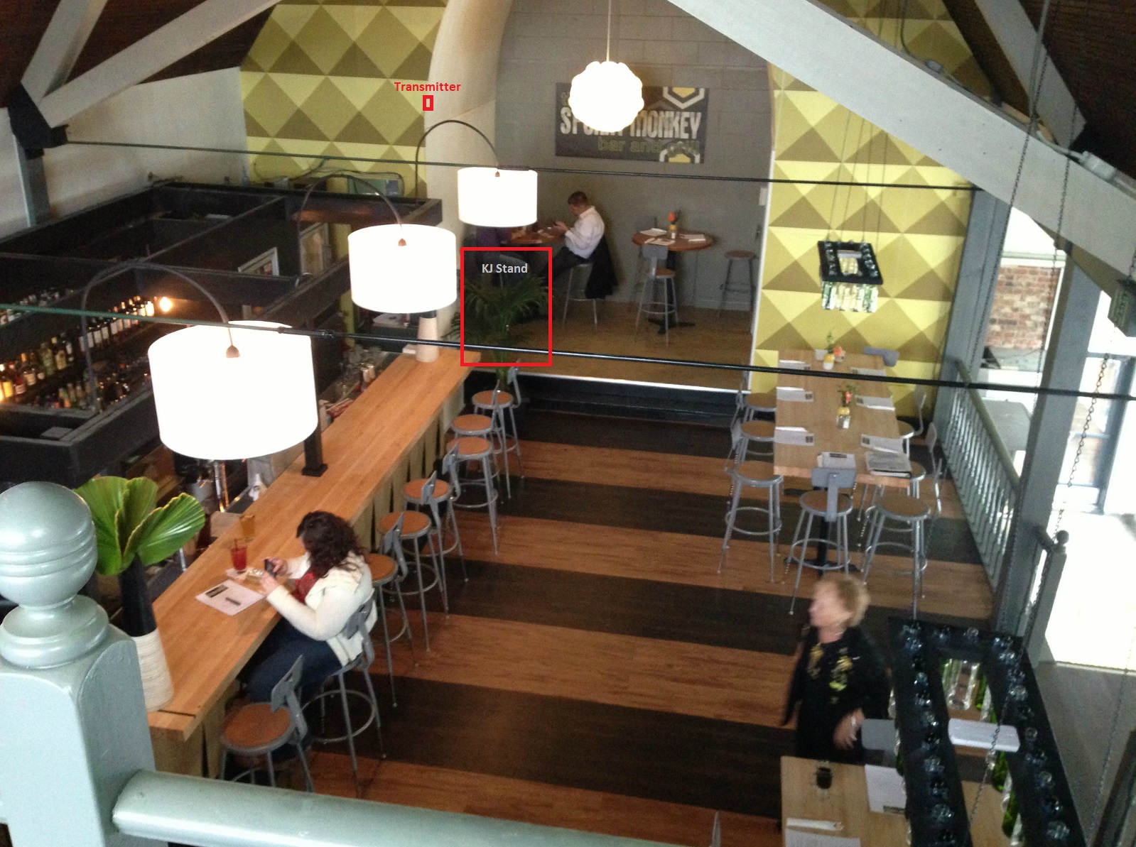

I use these - They are $99 at Fry's with the occasional sale for $79. -
***UPDATE*** - There are $79 - $10 mail-in rebate = $69 at Fry's this weekend. I picked up 5 more today. ***
http://www.diamondmm.com/wpctvpro-diamo ... to-tv.html
NewEgg sells for $88 every day -
http://www.newegg.com/Product/Product.a ... 6815306040
Will stream audio and video, but I disable the audio portion for karaoke to get smoother video.
Requires line-of-site so I make sure the transmitter and receiver are placed near the ceiling.
TV must have HDMI or VGA input.
Also great for travel. Keep laptop on night stand and stream Hulu, Amazon, whatever to Hotel TV.
Specs say up to 30' Range but they work a LOT further than that (see pics below). The key is absolute clear line of site. If anything passes between transmitter and receiver, you WILL lose the feed.
Pictures taken before I installed my gear. Distance from Transmitter to Receiver is ~50 feet. This is my new 7 night a week venue.
