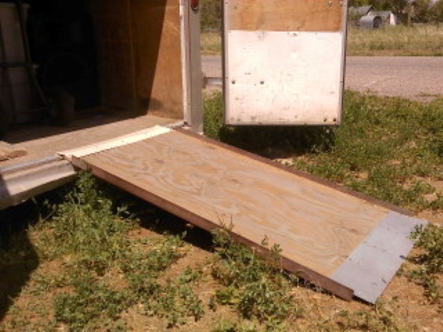

 Post subject: Re: Ramp
PostPosted: Sun May 27, 2012 2:13 pm
Easy answer... just build one out of a piece of 3/4" plywood, 2 pieces of 2x2 angle iron -coped at corners and bolted to sides of plywood.. then take 2 different pieces of lighter gauge flat sheet metal, and attach at ends of plywood to make the transition easy on your wheels... I made one just like this for my trailer, only weighs about 30 pounds of less. I just put it in my trailer with my gear.
Only cost me about 25 bucks to make... easy peezy

PostPosted: Mon May 28, 2012 10:13 am
Here is a pic of the one I built. It is about 5 feet long and about 30 inches wide. Has 2x2 angle on each side, coped at corners to remove sharp corners. Angle is bolted using nyloc nuts and short carriage bolts (pre-drill holes) At each end is a piece of lighter gauge flat metal sheets attached with wood screws (recessed) so the transition from ground to ramp,,, and ramp to trailer is easy on the wheels of my gear. The plywood is a simple piece of plywood 3/4 inch thick cut down to the size I wanted. Very study, not slick and only took about 45 minutes to build. I can handle it with one hand easily and it stores inside my trailer with all my gear.
Like JD said,, K.I.S.S. .. Keep it simple stupid... no need for elaborate or expensive store bought stuff. Nothing to be ashamed of to build something that works for your needs.
PostPosted: Mon May 28, 2012 6:40 pm
I like this.
