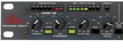

Mixer :- Allen & Heath Zed-14
Compressor :- dbx1046

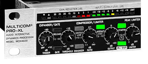

Compressor :- Behringer MDX4600

I hate to say this but I'm not sure how helpful this thread really is. Dynamic processing in general and specifically compression, needs to be set specific to the input signal received. In other words, each singer has their own requirements for how the compression should be applied. Ultimately, it takes an understanding of what compression is and how it works plus a good ear in order to get this right. I'll post some general guidelines as far as the parameters I have set on my compressors and hopefully that will help.
I'll focus on only four parameters, I think most of us use compressors that have automatic or interactive modes where you don't have to set things like attack and release times.
Threshold: Typically this is somewhere between -20db and -10db for most singers. Louder singers you'll generally set a lower threshold (closer to -20 than -10) and then use a lower ratio to keep the compression smooth and avoid "pumping".
Ratio: Typically between 2.5:1 and 6:1. As mentioned before, use a lower ratio for louder singers and a higher ratio for quiet singers that need a lower threshold.
Output gain: Should always be 0 db (unity). If you set your input signal so it peaks around 0 then there's no reason for any gain on the output side. Adding boost here only serves to introduce noise and possibly distortion. Use the trim (input attenuation, gain control, whatever you want to call it) on your console to get this right. This should be reset for each singer as well.
Peak Limiter: Usually stays static at around +3-5 db. Depends a little on your console and where it's clipper kicks in but 3-5 db should be safe for most if not all consoles.
The other thing I'll offer here that should help is this. When a singer is singing at normal volume. You should see little to no compression being applied (watch the meeters). When they really lay into it then you should see the compression come up and start locking down the channel. The peak limiter should almost never get hit and should be very short and transient when it does.

Karyoker which dbx unit is this ?
Marble what compressor do you have ?
Its a DBX266XL. I usually run the threshold about -10, the ratio about 3 and overeasy on.
