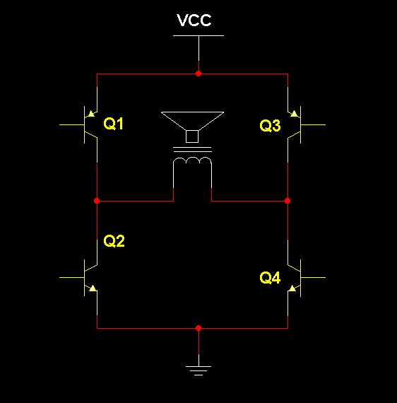

To give one example why, consider the H bridge circuit. An example with a speaker is attached but this type of circuit is commonly used for many other purposes as well. To drive the speaker in one direction Q1 and Q4 would be turned on. Q2 and Q3 would be used for the other direction. Now consider two of these circuits were wired in parallel. When the two outputs (Left and Right) were driven with a strong signal 180 degrees out of phase then Q1 on one channel and Q2 of the other would both be on. The power supply is effectively shorted out through Q1 and Q2. Unless there is additional resistance in the path or special protection circuitry something will be damaged.
Many manufactures, including Peavey, recommend creating a Y cable with two 1 K ohm resistors in series with the two inputs.
I have connected outputs from CD players and other such devises using a simple Y cable with out problems. They, however, have high impedance outputs and use different circuitry which is tolerant to such abuse. Power amplifier outputs would be a definite no no. Mixers are a middle ground and I admit that I don?t know for sure. (notice that I waited until paragraph 5 before admitting this.)
