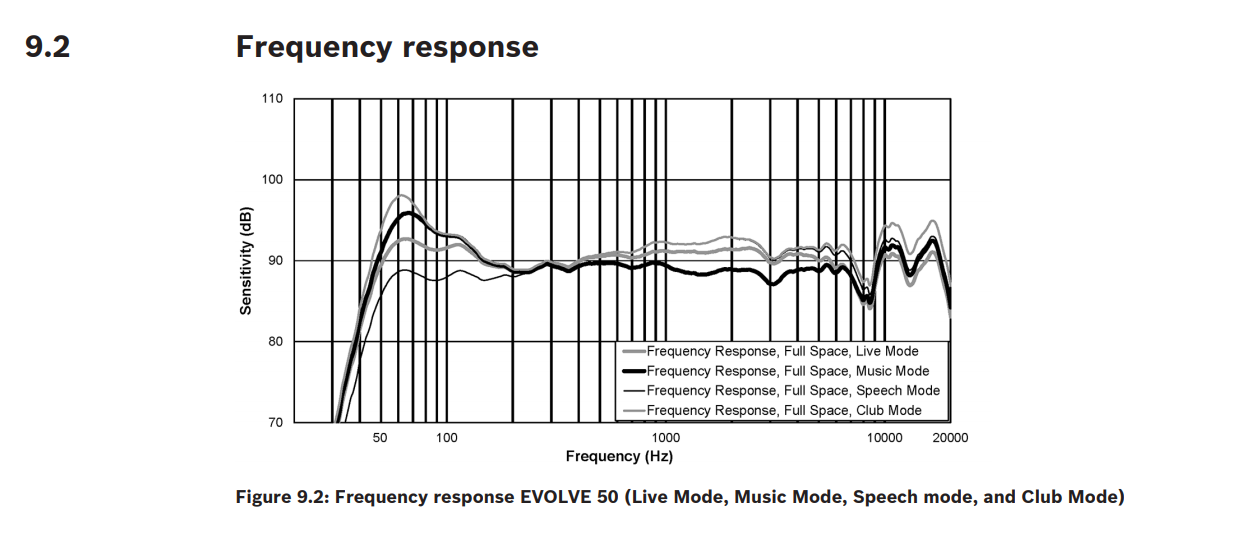

That's one of the onboard DSP presets, and is far from 'flat'.

they recommend not using that one for vocals. but what does EV know?
PostPosted: Mon Apr 01, 2019 2:13 pm
Hardly 'flat' response lol. Nice bump the bass and treble and cuts in mids. Closest to 'flat' would be Live mode.

The MUSIC mode is the default position and the one I have always used. The sound is incredible and needs no additional processing. Seriously, it's that good. If you don't believe me, just ask Mr. Scott.
PostPosted: Mon Apr 01, 2019 3:24 pm
Sure for music it might sound great using a subtle form of the smile eq shaping with the boosting of the highs and lows and cutting the mids a bit. Which is probably why the Breakaway setting you were using sounded 'bass' heavy lol.
