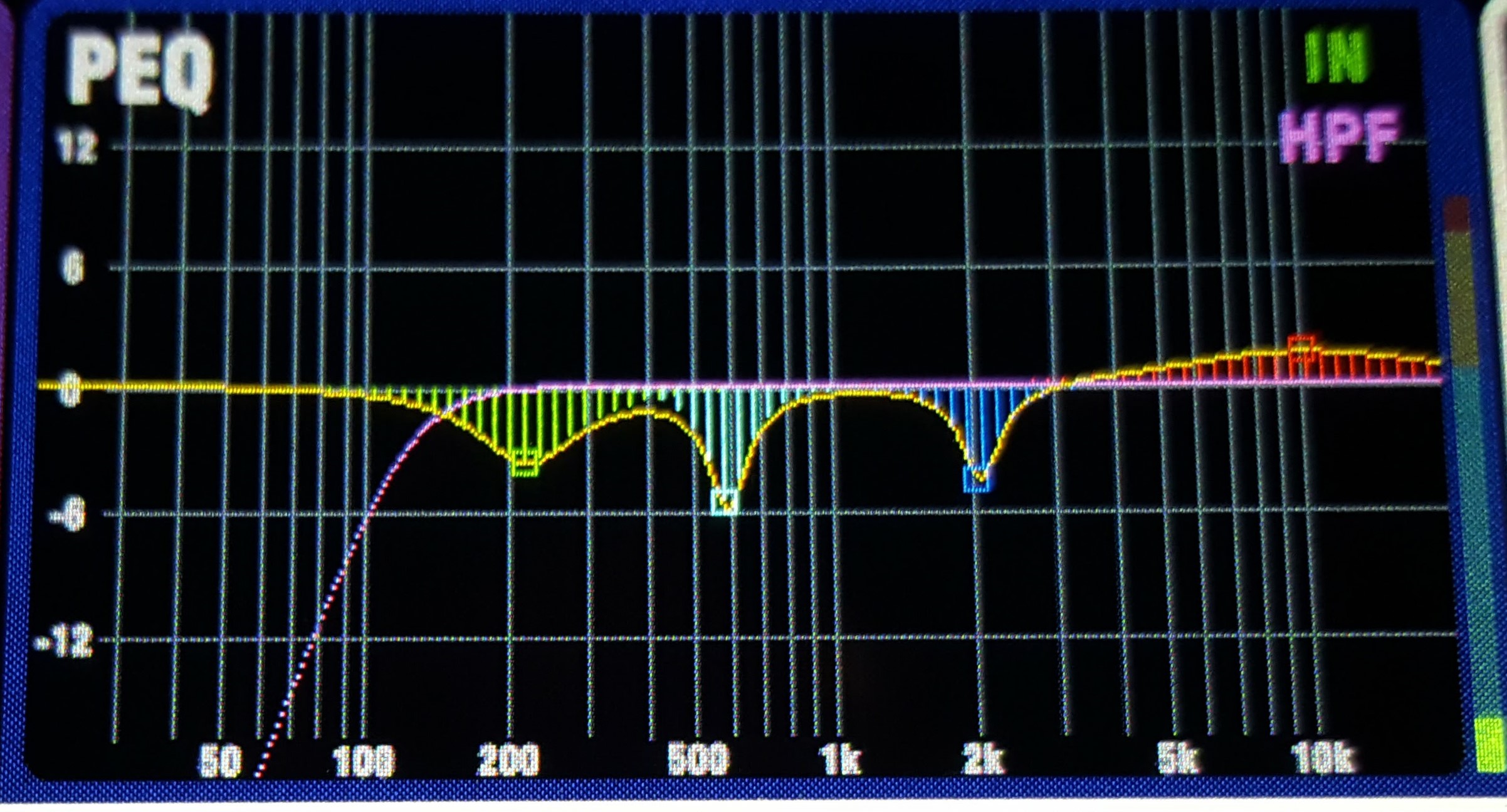

PostPosted: Thu Feb 02, 2017 3:23 am
Posts: 114
Been Liked: 29 times
CafeBar wrote:
Screamer and Mechanic:
Where do you center the mid cut on backing tracks? I'm not using a parametric but I have a mid-sweep on the channel EQ. Would you give a corresponding boost at the same spot for the vocal to make it pop out more?
If I were working with analog board with a mid sweep on the music channel I would probably center it somewhere around 600hz give or take. Probably cut it 3-5db. Since you are dealing with a semi-parametric EQ you can't adjust how narrow or how wide of a range you cut or boost. So that is going to depend on the board.
Ok, on vocals, I am working with a digital board so I can be a bit more precise, but I hardly ever boost anything on vocals except the highs a few db for intelligibility and breathiness. Everything else is cut, first the high pass filter is engaged, second I make a cut in the lows that ranges from where the high pass filter leaves off to roughly 400hz, centered on about 250hz. Third is where your mid range sweep comes in, this will vary from singer to singer. You are going to make a cut here based on the most dominant frequency in their voice, everybody has it but it varies from person to person. This is going to range from 400hz to about 1k. Whenever I try to explain to someone how to find that frequency I tell them to sweep it back and forth slowly until they find that sweet spot. You will know you found it when all of a sudden their voice clears up. It's actually the opposite though, that sweet spot means you found and cut out the most obnoxious frequency in their voice. I make a small cut around 2k this minimizes the consonant sounds like "C" & "K" this cut is not as necessary as the others in most cases and probably could be left mostly flat in this area. So on an analog board I would cut a few db on the LF knob, cut a few db from the MF and sweep to find each persons offending frequency. Boost the HF a bit. If you do it this way you will find the voice to sound much more clear and natural. You also should be able to get a bit more gain out of the mic channel and have a bit more headroom on the fader before feedback.
These EQ settings I have outlined are based on using a Sennheiser e835 microphone and should be very similar for a SM58, different mics have different coloration and may not need as much cut out of the bottom end, this is true with my beta 58a and especially my beta 87a.
I am attaching a picture that should illustrate what I am saying fairly well. Hope this helps.
