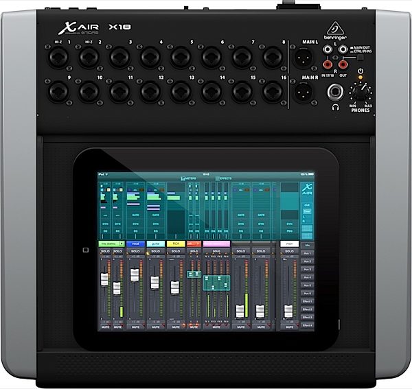

Is the compressor another piece of gear? Or is it something I set up in my XR-12?
My Lexicon Alpha arrived today, but UPS delivered it to my neighbor's house, hopefully they will fix the issue so I can get to work setting it up.
PostPosted: Tue Feb 26, 2019 12:59 pm
The mixer has compression built-in. You have to pick your channels and set it up. I am getting a x18 because it comes with the USB interface built-in.
