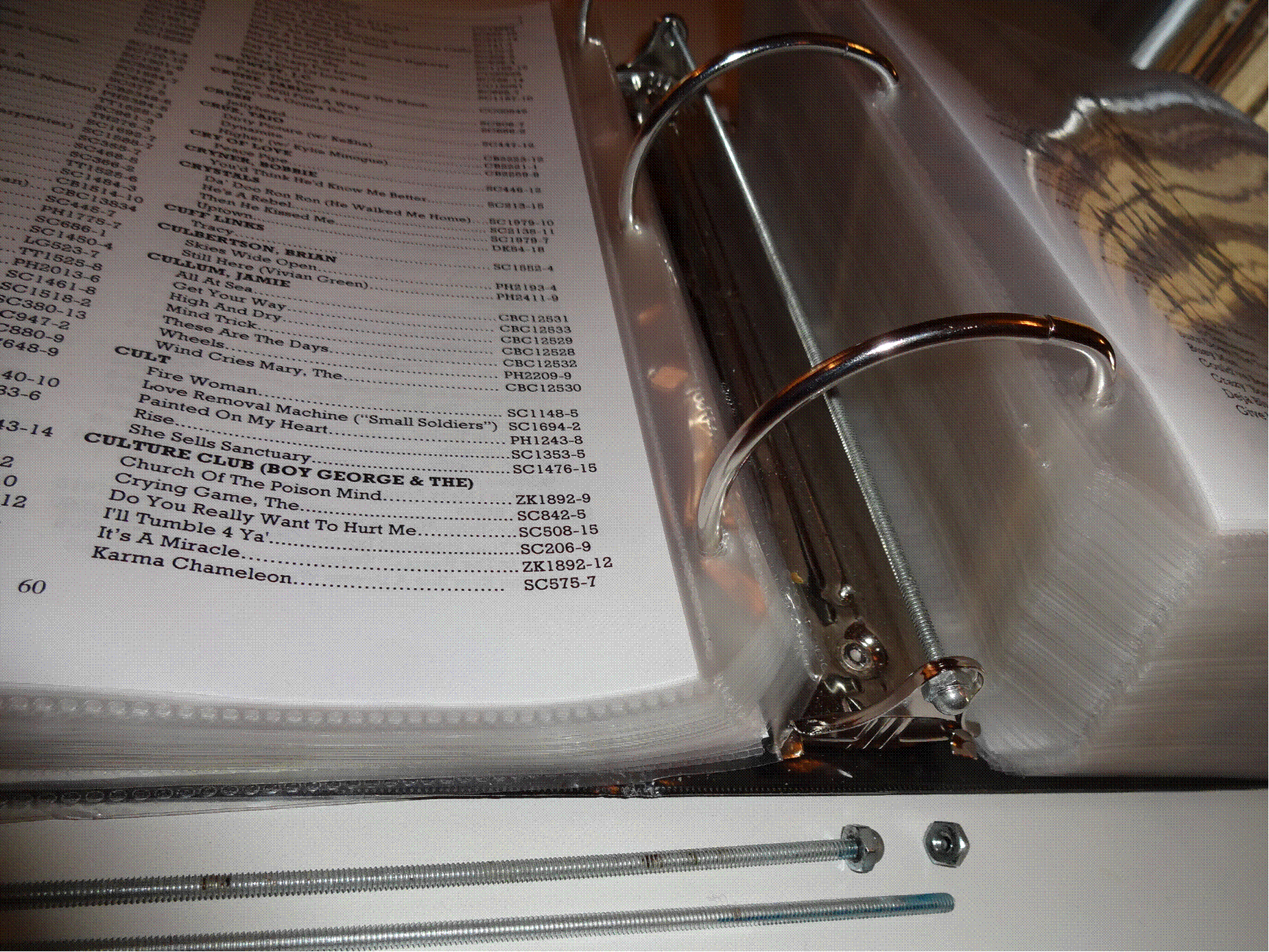

Pages coming out of place or falls out all time? Here’s my solution. Easy does it! Drill a hole in both the center of the release ends, insert small metal rod cut to size & secure it with caps tightened with a pair of pliers (no slack, tight enough that the release tabs doesn't move backward or forward). Avail @ home depot. Less than $10 for my 10 books. The rod will prevent the books from unnecessary opening.
Want to add more pages for new songs? No problem. No need to detach the rod. With two fingers, the ring(s) will open up with just little space gap enough to insert plastic sheets. The opening of pages will function normally as the rods are in the middle & will be not be in the way. I completely update my books twice a year to incorporate new released songs. That’s when I remove the rods.

Brian, That's very ingenious! I ike the cap nuts for a really neat and tidy appearance, but would nylon nuts prevent loosening a little better? Forgive my suggestion if you have already tried that method. They make 2 types of nylon nuts: 1) all nylon, 2) metal with nylon insert. Both are available in the size needed. Great idea!
Brian......*THIS* is precisely the kind of thing I expected when I came to these forums. Absolutely fantastic, creative problem solving. I may just change my books completely now after this post. Thank you!
mrmarog: haven’t tried the nylon nuts but I’m sure it will work. Oh, the reason for ‘plier tight’ & not finger tight - to prevent the cap nuts from getting loose and/or for anyone trying to open it. Who would bring a pair of pliers @ the venue? :lol:
Thanks for the compliment, chris. I myself benefited so much from other posters as well, such as recommendations, equipment upgrades, etc. That’s what these forums are all about; exchanging of ideas. :D

Brian, Great Idea! I am going to do just that this coming weekend. Great idea! :clapper:

I second or third or fourth that Brian too.
And that's a lot less expensive than buying the spring post binders, although they ARE awesome, but don't have front page inserts.

@ Llizard's post - Very funny! LOL Hose off the puke! Ewww. Need to reach for paper towel to wipe of coffee spits from laptop screen. :lol:
Some warm heated discussions going on up there. Only means a lot of people are participating & discussing this topic enthusiastically! :)
Drilling a hole to the binder release tabs can be a little tricky – but not if you use a center punch to make a little ‘dimple’ right where you intend to drill a hole. Otherwise, your drill bit will be all over the place. But you guys already knew that - just a little suggestion for others not quite as handy.
Just open the release tabs, tilt at 45d angle propped it at a wood block & drill away! Good luck! :)

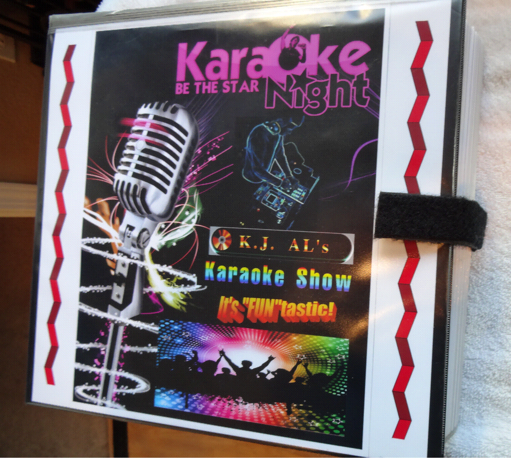

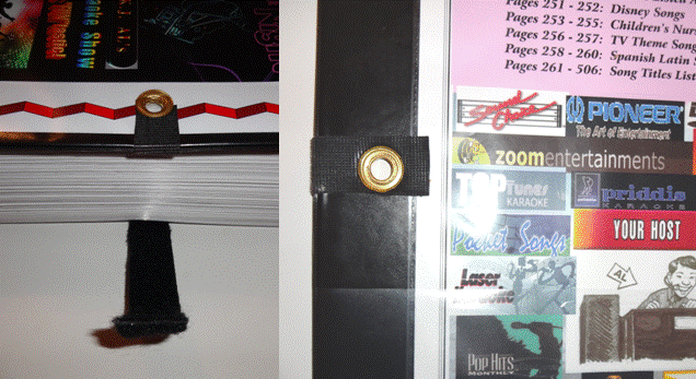

Optional Velcro Strap when your binders get thick & heavy. Very easy to do. I like it because it prevents the book from opening like ‘butterfly wings’ :) & also firmer better hold when they pick it up. You will need the following:
1. Grommet size 3/8” or 10mm http://www.lowes.com/pd_308798-355-BFG2 ... facetInfo=
2. Heavy duty hole puncher. http://www.homedepot.com/p/General-Tool ... Vuaejc4qF8
3. Industrial strength Velcro. http://www.homedepot.com/p/Velcro-Indus ... VuJFTc4qF8
Front: Cut to size rough side (hook) Velcro 3½ ” long, width – 1” . Remove the backing tape; press middle Velcro at the edge, then press flat & overlap. Make the hole. Align grommets, hit puncher with a hammer (tool #2). That’s it.
Back: Same process, same width, but length longer to function as a strap. Length depending on book thickness. Length on mine-7”. Cut Velcro hook side (smooth) X 2. Yes, two pieces. Remove backing protection, (attention to alignment, those suckers can adhere to one another like a sonofab*) press both sticky side together but not the whole length, allow 2 ½ inches opening at the end, one goes above, the other below it. Punch hole & grommet.
 Post subject: Re: Song Book Binders
PostPosted: Tue Apr 02, 2013 7:14 pm
Finished product.
