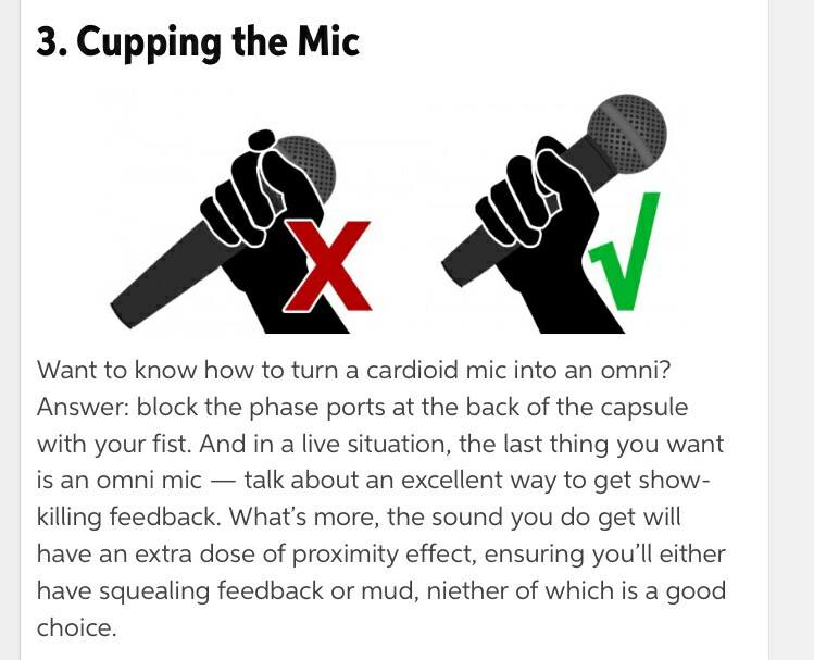

Do you notice the words "Phase Ports?" Yeah, the bottom half of the capsule has "TUNED" ports. Meaning, sound MUST come into the bottom back of the capsule in order to "CANCEL" sound coming into the front and sides. This makes the MIC UNI-DIRECTIONAL.
Allowing a Singer to place their HANDS or FINGERS to obstruct ANY of these TUNED PORTS causes the MIC to become OMNI-DIRECTIONAL and subject to FEEDBACK.
This is NOT allowed at any time and I, too, have a MUTE button. I will interrupt the Singer to get it corrected. If the Singer does not comply, their MIC gets MUTED.
This is not true. An Omni-Directional mic will pick up sounds from all sides of the mic head. Front, back, bottom, top or sides. If you cup a Omni-Directional mic but leave the top exposed will still adequately pick up sound. On the other hand, a Cardioid mic is directional picking up sound from the front. It is this type of mic that is affected by cupping since it can block the sound causing feedback and distortion. However, no mic should be cupped. That's why there's a handle in which to hold it. And no mic should be exposed or used near a loudspeaker which can cause feedback although a Cardioid mic is better at minimizing feedback.
I guess I wasn't CLEAR, obviously...let me clarify. And, as much as hate quoting something that I didn't even talk about for fear of lending credence to the post, now, it seems, I must.
First of all, I was referring to a UNI-Directional MIC being used in such a way that it becomes an OMNI...is that CLEAR? Who in the Hell uses an OMNI at a LIVE Karaoke show, which seems to be what the F#@% we were talking about? So, why am I being schooled on an OMNI?
Second, did you think that I made that graphic myself? Did you bother to READ what was in the GRAPHIC? The GRAPHIC came from a SOUND ENGINEER.
Here's another "Sound Engineer." Slide over to 2:09 for his dissertation on cupping the MIC. You might learn how a UNI becomes an OMNI.
https://www.youtube.com/watch?v=a-QHXtx7XJ0
