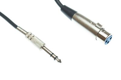

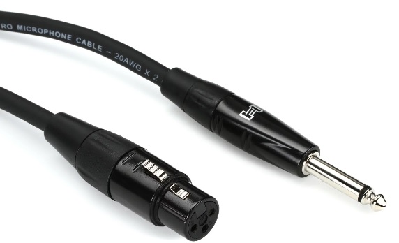

Some mics do not transition well from XLR to 1/4", you possibly bought the wrong cord too, on the 1/4" end is there 1 black ring or 2? If it's two rings - referred to as a balanced 1/4" TRS (tip/ring/sleeve or stereo), you need a single ring referred to as an unbalanced 1/4" TS (tip/sleeve or mono). I'm guessing the 1/4" input on the speakers is not a balanced input which is why you are getting no sound.
pro-audio-xlr-3-pin-female-to-1-4-in-stereo-male-cable-1.jpg [ 6.29 KiB | Viewed 30059 times ]
