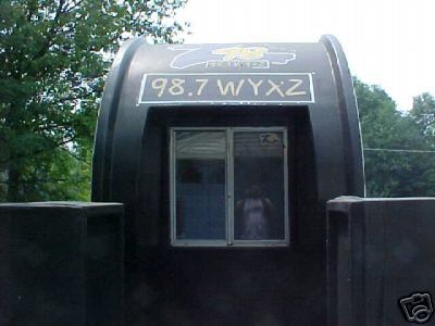

:?: Hello to you Guru's - here's the deal - I've obtained a Mobile DJ Trailer - 22' long Giant Jukebox. (Ebay - cheap). I want to use it for parades and need advice on generators and was wondering if any of you have any suggestions or warnings on sizes, makes, models, wattages. Equipment inside is 800W Pyramid Amp, Laptop, External HD, outside - 4 12" speakers. A/C Unit also may need to be turned on depending on heat outside.
I know it's a weird one but you guys are the best and I appreciate all your help. (and to think just a year ago all I had was one little unit and about 200 cdgs) :D Picture of Trailer attached if it works

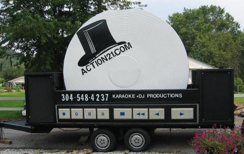

The A/C would only be required for no wind above 80 temps since the outside is black on the edges-see below. :P You know-when its hot :idea:
Without the air, on hot days, I'd toast and so would my equipment - especially since, obviously, this is all outdoors and as you can see there isn't much room for wind to blow thru.
My better half & I have taken your idea's into consideration and have found a generator at Sears for only $499 vs same one at home depot for $799. It is a 3600 W Generator with automatic circuit breakers with 220 as well as 120 capabilities and plugs.
Thanks for the quick replies - Respectfully Pat 8)
