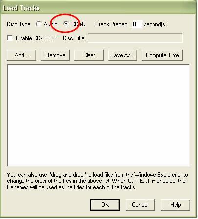

When you open up CDRwin, click on LOAD TRACKS. That will take you to the load tracks window. BE SURE THAT THE CDG OPTION AT THE TOP OF THE SCREEN IS CLICKED!!!! Please see the picture that I have attached. That should help. This is a very important step.
Also, be sure that the .bin files that you are loading here are the ones you are using. If you don't use the .bin, they won't work.
Once that is done, press okay. Then, it should compile a cuesheet automatically for you. Then, all you have to do is record, and you are good to go.
